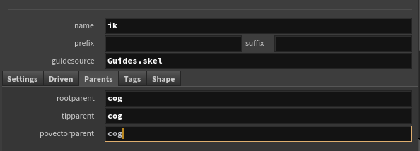

Hi I'm new to APEX and Kinefx, I'm trying to rig this ybot character from mixamo but I can't use the multiik autorig component
the shape just disappeared and I can't figure it out how to fix it.

Upload the character if you get a chance, it'll make it easier to debug what's going on.
Hi Max, thank you for your reply, I watched your tutorial on youtube
After checking the electra rig example, I figured out the issue
Model from mixamo doesn't parent the hips to the root joint that why it only shows the hips shape only
And also have to update the rootparent and the povecparent to "cog" as well.
Now it's working perfectly.
