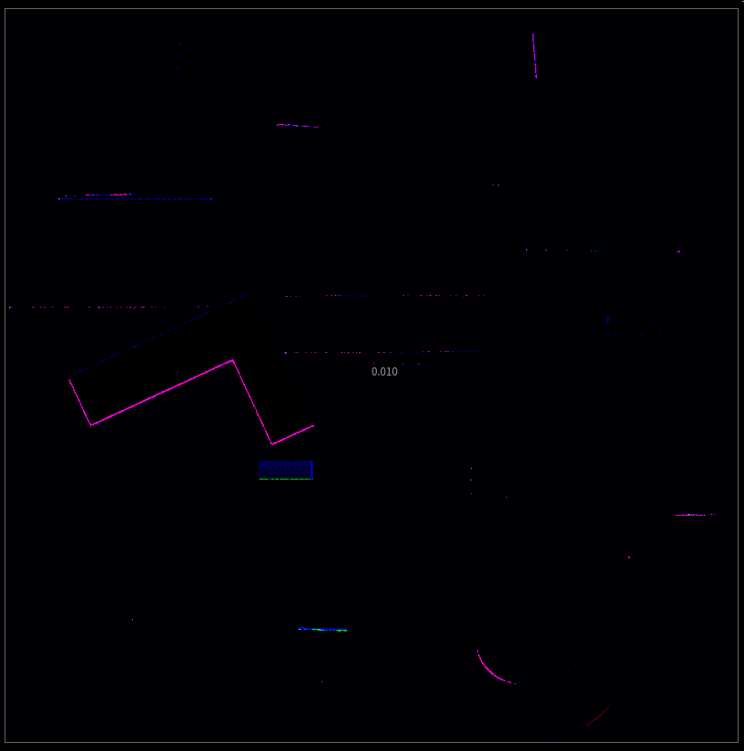

I do however have a follow-up question. It seems like going from 4k-16k I'm not actually seeing any quality difference to the content, its just being saved out in a higher resolution.
Am I missing something here? Setup wise its mostly just fractal noise / bake geometry textures / triplanar projection.
Looking into the graph I can see the noise improving in resolution, so I was wondering if the geometrytextures or triplanar was the issue. I've noticed on the bakegemoetrytextures that changing resolution seems to have a drastic effect on the output:
4k:
8k:
Maybe this is causing an issue to some degree, or maybe its just a display issue going above 4k?
Edited by dnew - April 10, 2026 05:16:50
6966 posts
Glad to hear the 50% worked around this.
That baked geometry texture looks very suspicious, if that was the output and not a display issue, I'd expect things to be massively wrong not just de-ressed...
Cropping or saving the output should let you see if it is a display issue.
For the lack of improved quality, there could be various things... First make sure you haven't switched to 16 bit precision to save memory. 16 bit floats only have 1024 different grey levels so when you use them for things like positions in fractal noise they'll start to quantize and stop improving. This is what led us to change our defaults to 32 bit everywhere, so unless you fiddled, it should be 32 bit. (But you had memory issues so may have fiddled :>)
There could also be precision problems even with 32bit, but for most stuff you have 16million shades of grey with 32 bit so you should be safe for a "mere" 16k.
8 posts
Joined: Jan. 2024
Ah yes, i was fiddling indeed! I changed to 16 bit precision on everything but the displacement but I've put it back to 32 bit now. I'll see if that helps once I get past the next issue.
I've just set things up in a fresh scene, new nodes sopimport/baketexture nodes and getting the same issue as before, things are fine at 4k but break at 8k. Written out to disk and viewed in nuke*
8k
4k
The sopimport contains an alembic > convert to poly > transforms > output
Anything I may be missing here?

6966 posts
dnew
I don't think so, if you can bundle this up, please submit a bug to support.
