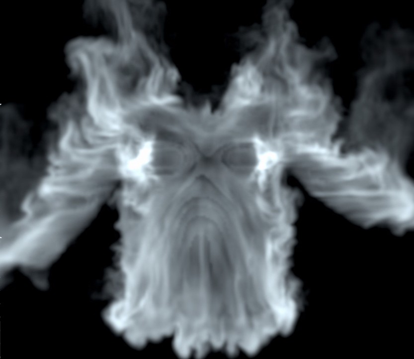

I have a smoke sim that emits from a characters upper body and flows outward and along the surface of the character, but I'm getting really gnarly collision banding. You can really see it in the alpha of the smoke render. I have been unable to clean up the banding artifacts in the sim, and I'm currently resorting to a post process.
The colliders are airtight polys with a collision sdf. The collision voxel size matches the size of the pyro sim.
The source is points that are peaked outward from the collision surface so they don't sit directly on the character surface.
Things I have tried to fix the artifcats.
  • Tried both static object collider (with deforming on) and volume source to source the collsion field and collsion velocity.
  • Tested increased max substeps between 1-3.
  • Increased collision field resolution and subdivided the collsion poly surface.
  • Tested with "fill object" on the collsion field and/or increased bandwidth.
  • Applied vdb_smooth_sdf to the collsion field.
I'm out of ideas at the moment. Willing to try anything.

The collision is going to do pretty much exactly what you've shown. Your SDF collider is not smooth, it
has ridges.
Put down a VDB smooth SDF, this will smooth it out.

I already tested with a vdb_smooth_sdf node as well as subdividing my geo prior to the collision_source_sop as noted above. But just to be doubley sure, I tried again and I'm getting the same results. I've included screenshots of my smooth sdf and the resulting smoke sim.

So either disabling Correct Collisions or removing density from the Field to Correct parm "fixes" the issue. I know this is not what I should do. But based on this it seems that collision field isn't doing a great job reseting the density field and creating these artifacts.
Edit: Interestingly if you use a Velocity Voxel Size multiplier, it will also affect the collision field.
