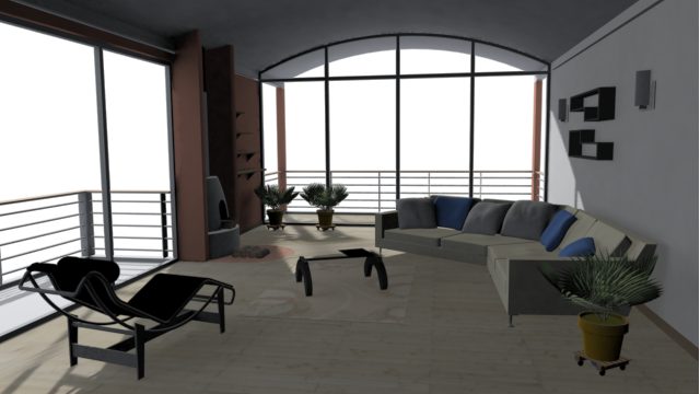

Ok, here's an interior scene I created in blender as an exercise to try the new yafray render code out:
You can grab the FBX with the required bitmaps here:
http://files.wildspad.com/afecelis/houdini/files/interior.zip [files.wildspad.com]
FBX imported into Houdini:
Glass materials were recognized as such! (though they're blender shaders, not bitmapped materials).
Let me know if it helps and if you need anything else. Also let me know if you succeed in getting the materials to render. Little by little I'll keep pn asking stuff
regards,
ALvaro
Wow, impressive scene.
I've imported the file you put a link to and played around with it a little. Here's the problem: materials which render wrong with Mantra have their diffuse coefficient set to 0, which effectively means you'll get no diffuse colour contribution (just the emissive and ambient in this case). However, the texture imported is set as a diffuse texture - so the renderer tries to apply it to the diffuse colour, which in the end gets multiplied by zero anyway.
I've also tried importing the same file into Maya, and it results in exactly the same grey colour instead of a texture.
You've got two possible fixes, both affecting the FBX shader node. One is to set the diffuse factor to something greater than 0 (however, I think in this case the texture appears to be mapped incorrectly); or to go to the tab “1” on the shader node and change the texture to be applied to the emissive channel instead of the diffuse one. In this case the plant leaves look correct, as far as I can tell.
Alternatively, it is entirely possible you could do some magic in Blender and avoid the whole issue altogether - but not being familiar with Blender, this is about as useful piece of an advice as I can give.

A quick update: actually, the UVs are correct. It's just that if you set the diffuse coefficient to 1, the emissive colour overpowers it. After playing around some more with the material, if you set emissive to 0, diffuse to 1, diffuse colour to something like (0.4, 0.4, 0.4), change the texture compositing type to “Add” and change the Alpha to 1.0, the material will look properly.
Note that for some reason, the exported FBX file also has the texture alpha value set to 5, even though it should be in the 0.0 - 1.0 range.
