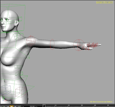

Here's the T Pose:

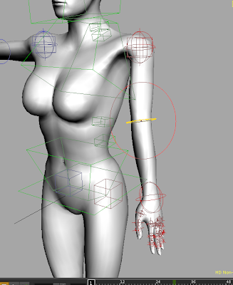

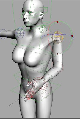

Next I bring the arm down, and then I would expect to rotate the forearm next but I can't because the only axis I can rotate is the X axis, which is NOT what I want here.
To get the pose I want I have to do an awful lot of twisting which looks horrible.
Is there something I've done wrong? Is the model incorrect?

The problem was with the original set up in the auto rig asset. When I moved the elbow controller to position it, it changes the direction of the arrow, from it's default position of pointing back, horizontally, to pointing downwards, vertically. This in turn changes how the rotation occurs, and ends up causing a problem. As long you're aware of this and you're *very* careful about how you move the elbow control everything is OK. But it's really easy to screw up.
