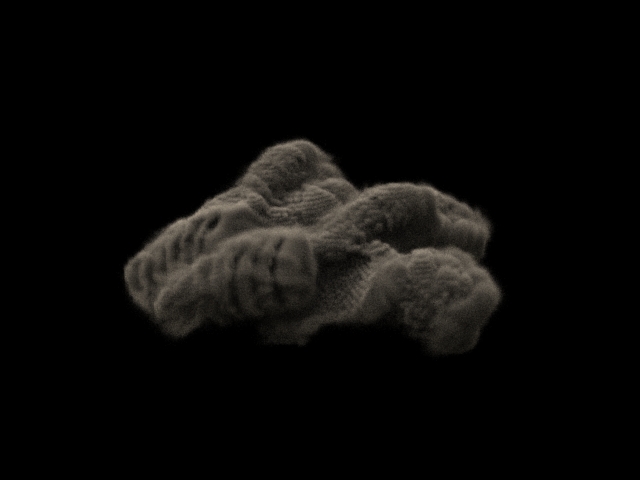

I am using h12 and when I increase the resolution of pyro smoke by decreasing the Division Size (0.05) of the container, in the renderings the smoke is pixelated as you can see on the attached image. I dont have change much from the default shelf setup (billowy smoke). What I am doing wrong? Also I have attached the hip file.

If you are referring to those bandings,
- Decreasing the Volume Step Size on your Mantra ROP
- Change Volume Filter to Gaussian (import_pyro_build geo > Render Tab > Shading Tab)
Increase the Pixel Samples, Ray Samples and Sampling Quality (env_light) will help eliminate the noise, gotta play around with the numbers to see what gives you quality render at reasonable render time, have funn!

nikoDan
I thing it's a filtering problem; Did you try to switch your filter type on the import_pyro_build node with blackman filter ?

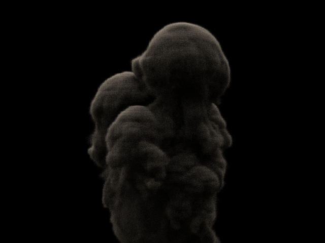

yes I did, it gets a bit better but still it look like sliced. It seems that has something to do with the shaders. I have attached image of another example, billowy smoke default setup with division size 0.05.

thanks guys, it seems the volume filter has the most important role in this. Gaussian has the smoothest result and Blacman is the middle of Gaussian and Box Filter. But based on Andrew Clinton's tutorial https://vimeo.com/40300224 [vimeo.com] the new default boxfilter is the best choice of hiress fluids.
