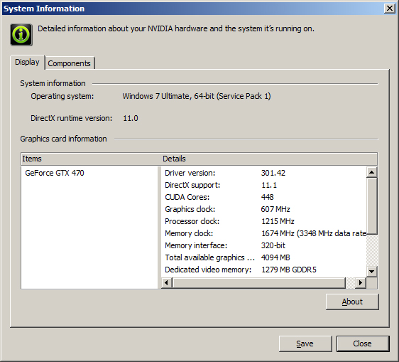

Well I get them regularly, even the simplest things.
For me it's:
Win 7 x64
Nvidia 470 GTX, driver: 301.42
I7 980x
16GB ram
This has been happening way before H12 was out, and over more than 1 machine, and I don't use GPU processing either, as my card only has 1GB of dedicated memory.
I will attach an image of my $TEMP folder where my crash-saves are located, and you can see by the dates that it's quite regular. My files are not really heavy in anyway. Most are just minor things to pass time whilst I'm doing something else (like whilst my laptop is busy, I faff about on my desktop and vice-versa).
I will attach a couple of .hipnc files from the $TEMP directory for you to look over.
One is a re-sampled curve emitting particles. Low particle count, a couple of nodes thats it.
One is a box, with some divisions with divide node running to a subdivide, and 2 bone…bone chain.
One has quite a few things going on and it crashed mid solve (RBD+pyro sim, so you might want to hit escape upon opening to stop the sim calculating (the 3524.hip))
Feel free to have a poke around, and if I'm guilty of stupidity (which has been known before), then let me know.
