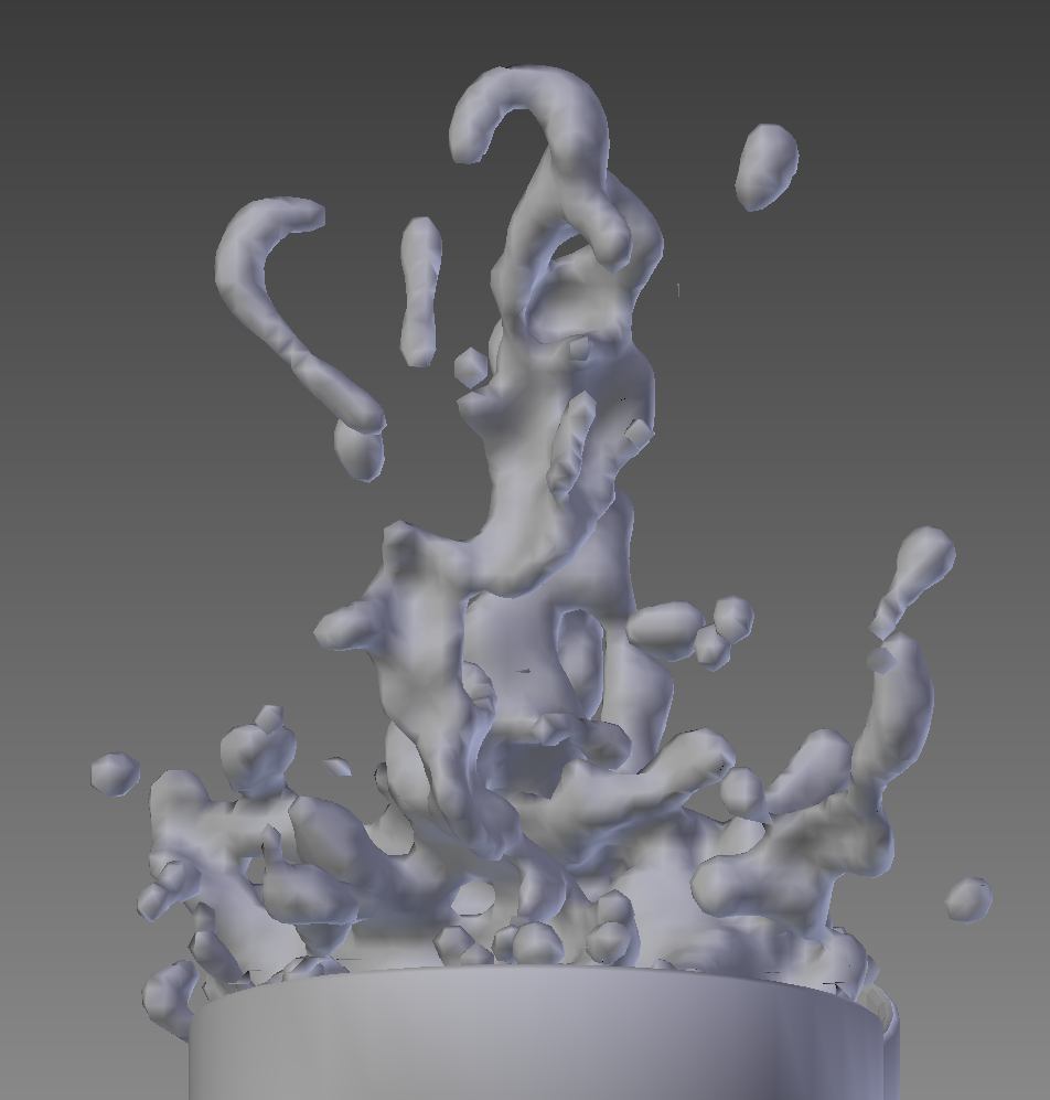

In my example the fluid reacts surely in a proper way but it looks too compact. I look for a way to have the fluid more splashy.
After looking into the help card, sidefx say's that the pressure holds the fluid. In the flip solver I cannot change that and I have no idea how to do this.
1. Is that the right way to get the splashier behaviour and how can I do this?
2. Are there other ways with FLIP?
Thanks
BLENDER Fluid 2.png (359.5 KB)
BLENDER Fluid 1.png (490.5 KB)
FLIP Fluid 2.png (153.2 KB)
FLIP Fluid 1.png (211.7 KB)
own_beer_splash.hipnc (1.4 MB)

try reducing the volume smoothing and also decrease the volume collisions surface extrapolation

I tried to tweak the settings you mentioned but that hasn't changed the shape of the fluid.
390 posts
Joined: Jan. 2012
if neither of those worked you can try and force a more hectic splash by adding some noisey velocity to your collision object. if you do this i would still keep those other 2 values lower as well though.
