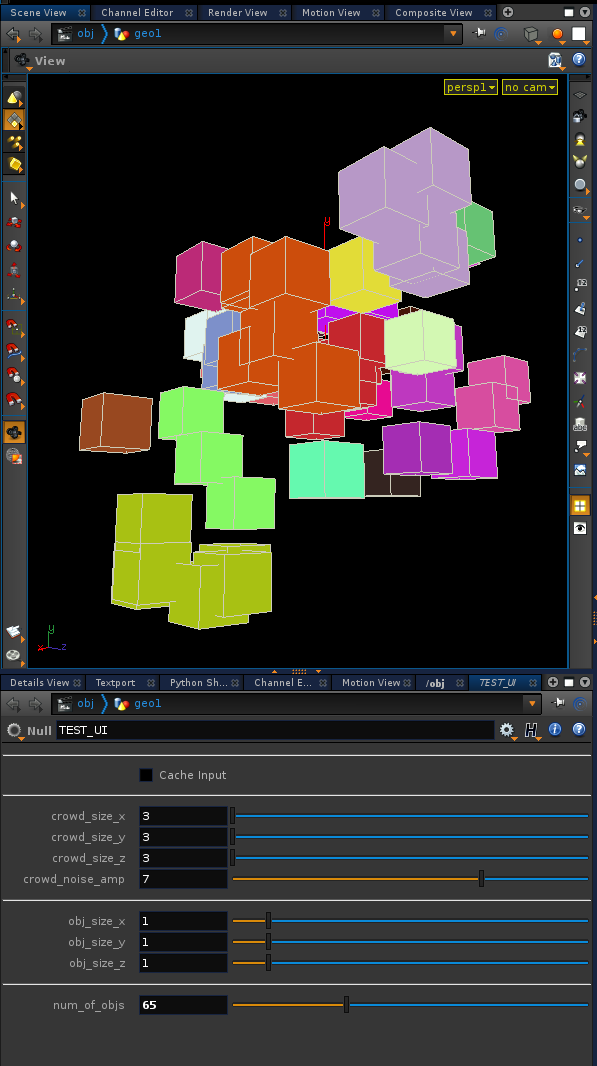

Hiya,
I have a wee issue with grouping primitives. I have a single mesh ( it comes from an .obj ), with multiple “sub-objects” in it, just connected primitives. I can do a group for each connected primitives with conectivity and partition SOP. But I need to create a group per groups which are intersecting or not far from each other ( with a radius value or something ).
You can see the problem in the screengrab I've attached. I'd like to have group 1-2-3-4 in groupA, 5-6 in GroupC and 7 in Group B.
I'm trying something with a for each node and intersecting vopsop node, but I'm a bit lost, anyone could help me on that ?
Thanks !

330 posts
Joined: July 2007
Cetras
.. I'll keep searching ! thanks
no wait !
try this suggestion :
- ignore nodes in gray .
- nodes in yellow do the job .
- there is a null to ‘play’ with values just for quick testing ..
.cheers
intersectingShapes_00_clean.hip (76.1 KB)

41 posts
Joined:
yay !!! Thanks a lot that does exactly the job !
