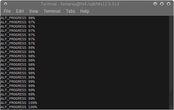

bradcarveyYou must launch Houdini via console. Open Console from houdini folder (windows) or Houdini Shell (mac), then type houdini.
When I hit render on the render view, the console opens and is in front and I see lots of rendering messages. When I hit render in the Mantra properties, I did not see a console window. Now that I am getting the info I need in the console, I will do some experiments to determine if there is an issue with where I render..
You could see each events from houdini (very useful) and mantra verbose when you render from a mantra node. You don't need to setup verbose level more than 0 if you only need to see ALF progress.
