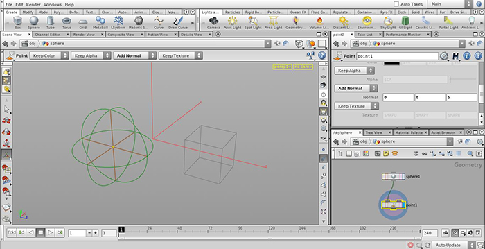

**UPDATE**
Figured that, I got this (see attached).
What I want is just 1 point normal from the center of the sphere. Is that possible?

Yes, Houdini can make one point at the centre with this perfect expression:
http://www.sidefx.com/docs/houdini13.0/expressions/centroid [sidefx.com]
put this into an AddSop to create the point, the attach a PointSop to create the normal
