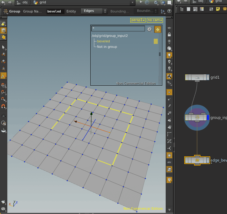

93 posts
Joined: March 2014
Houdin 15.5
temp1.hiplc (57.5 KB)
