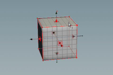

After an edit sop with a Soft Radius higher than 0 the whole tweak edit method is broken and does not work anymore. It selects random points and goes total berserk for me.
Before I submit a bug i want to make sure its not my system or some driver issue. So is anyone else getting this bug??
You can quickly test by
- placing a box and adding a few divisons.
- Select a point and move it around. Put Soft Radius to 1 in edit sop.
- Now dont switch to selection mode but try selecting a point or edge like you are usually able to and move around. It does not work.
- Commit Transform and Put the Soft Radius to 0 and its working again.
