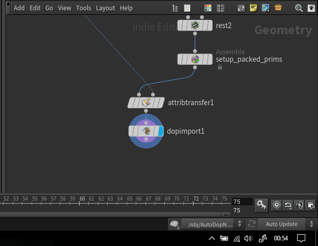

I've just checked your attached hip file and think that your object visibility should look like the first screenshot.
Inside your exploding ball, make sure to make the last node the visible one (screenshot2)

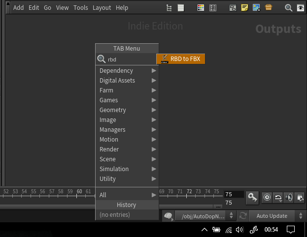

For export i would use rbd to fbx node (screenshot3).
Should work then.
Should work then.
