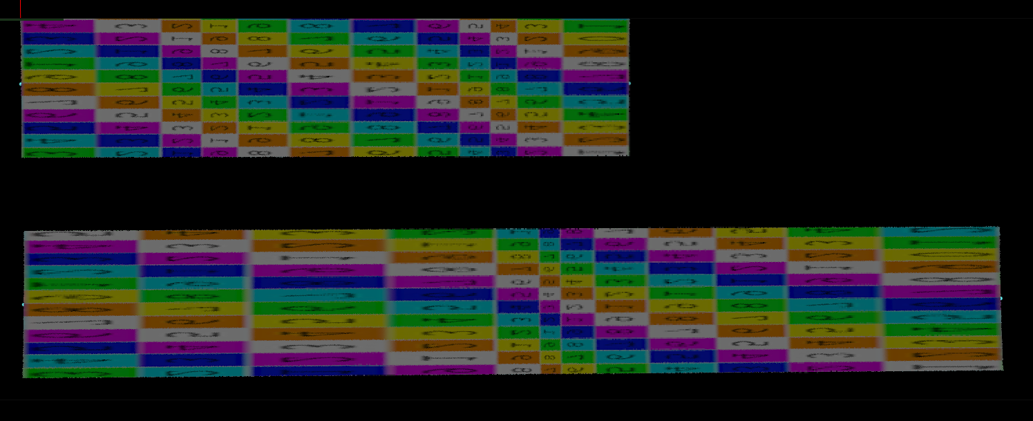

Frustrating thing is that I cant seem to get past setting a uv attribute without creating a distorted texture. I included some pics as well as the scene.

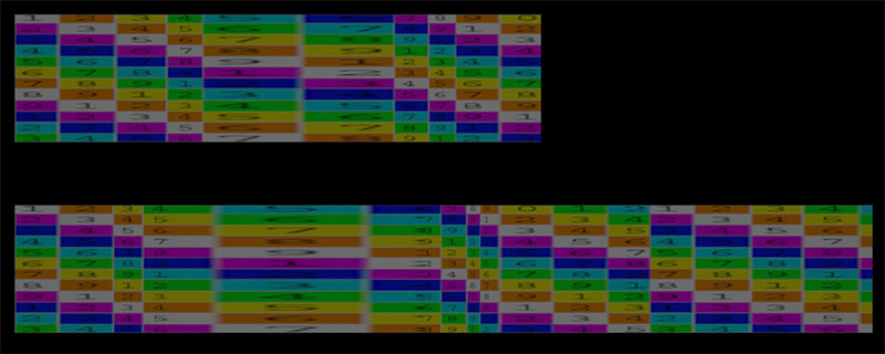

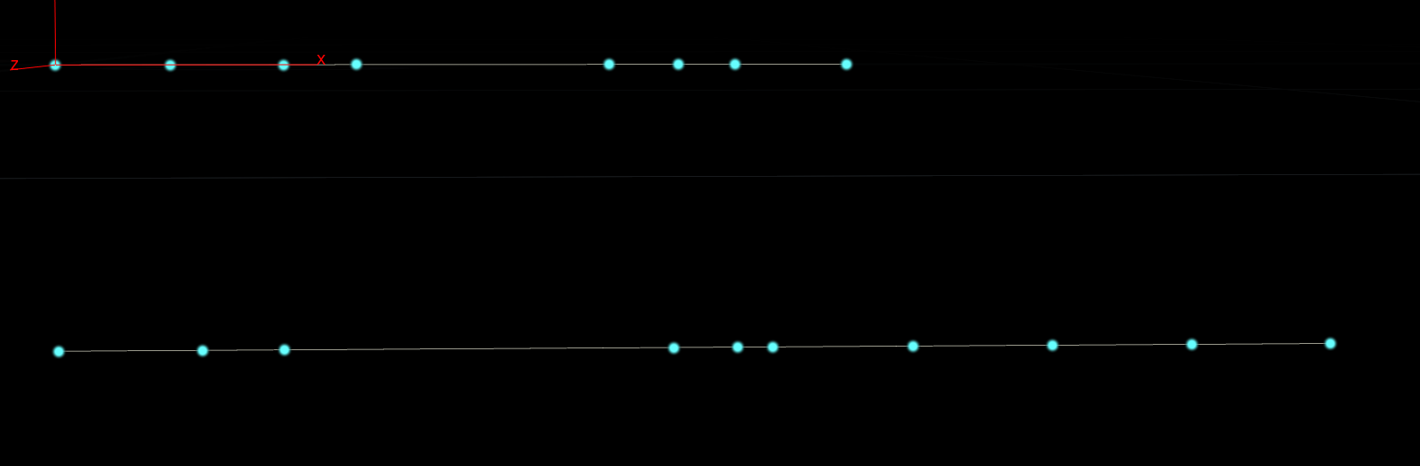

apologies as I learn the ropes here, if the filenames aren't visible the images may need some explanation.
Image 1 - Line with uv added, texture streaks
Image 2 - Line with no uv, texture stretching based on line segment length.
IMage 3 - Source line showing different length segments.
Again all I am trying to do here is to find a way to add a consistent texture size across the entire line regardless of point positions or segment lengths.

thanks for doing that but it is not what I am looking for. This result is actually what I am trying to find a way to avoid.
the texture projection is not correctly rendered (at least to my expectations/hope) it seems to be streaking in that only the top row of pixels across the surface of the line.
If you turn off the uvtexture node in my scene it will render the pattern correctly or view the referenced texture in the material.

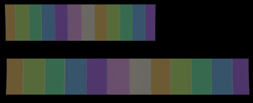

thanks jsmack, this of reflects where I am with it as well
jsmack
The only way I have found is to force all the segments to be the same length using the resample node. The uvtexture node has options for various types of uv parameterization, ‘arclength spline’, ‘uniform spline’, etc. None of these modes seemed to take the cake for me either.
