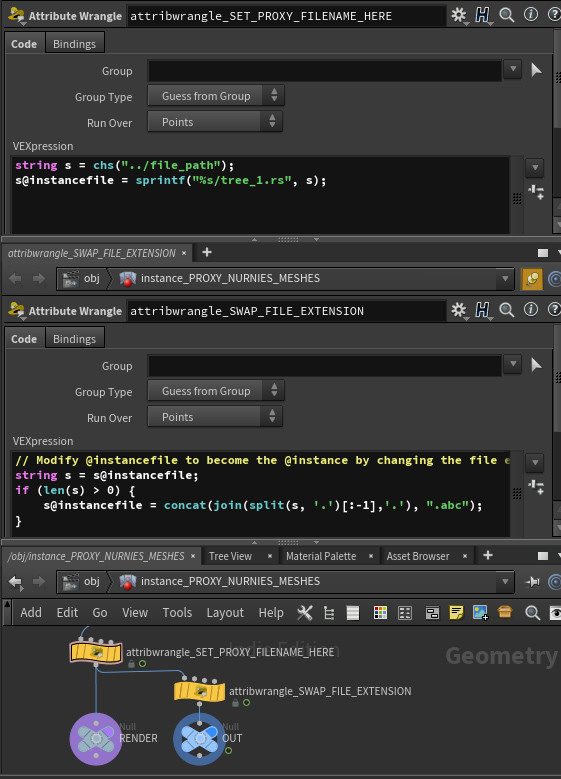

Here is what I have been playing around with. It leverages the @instancefile attribute for an instance object. In my case I have a folder structure, similar to your own, but instead of .abc files i have Redshift proxy files with the .rs extension I also have a companion version of the same object in the .bgeo.sc file format. In my image you can see how I split two different file types for different tasks. When Houdini is rendering, the @instancefile is set to a .rs redshift proxy extension when I am viewing my instance in the viewport Houdini will use the .bgeo.sc version of the file because I have re-written the filename with an alternate extension just for the viewport.
In your case, the viewport and render can use the same file extension.

I'm currently trying to recreate this setup, but with mixed results. While the .rs part of the network seems to work just fine, the .bgeo part isn't showing up in the viewport, neither does it render, when both display flags are pointed to its output node inside the Instance geometry node.
The only luck I've been getting with displaying the instances in my viewport, was when the path was pointing to a node in the scene, not a an external file.
Any idea how to get this working, or what I might be doing wrong?

I noticed this same technique was not working consistently using H16.5.378.
I think it is just a bug in Houdini. Instancing and the viewport is certainly flaky.
I am waiting for Redshift to be compatible with the latest H16.5.496 release then I'll test again.
One thing to review, which has got me a few times, is the Display/Render flags inside the Instance node. Make sure you have the Pink color on the .rs proxy and the Blue color on the swap file extension.

thanks for the reply. In the end, I did a workaround, where I left the .rs part of the network as you show above, and substituted the part that creates the .bgeo.sc @instancefile attribute by a for loop, that contains a copy to points node.
Not only does it work now, but I also get the dynamic culling in the viewport, that goes along with using packed primitives for display, so it works even much better than the original approach.
