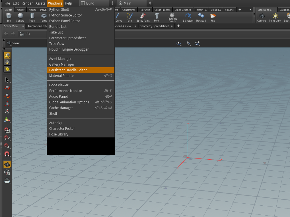

Hi guys, I have problems with the menus in Houdini and I do not know what to do anymore.
I attached images and other information. I would be very grateful if you know the solution to this or if it happens to someone else.
Thank you very much.
Houdini FX Version 16.5.378

1743 posts
Joined: March 2012
Looks like a graphics driver issue. Apparently 381 fixed some issues in the 378.66 you have now. Try upgrading to a more recent one. (I'm on 388.16)
