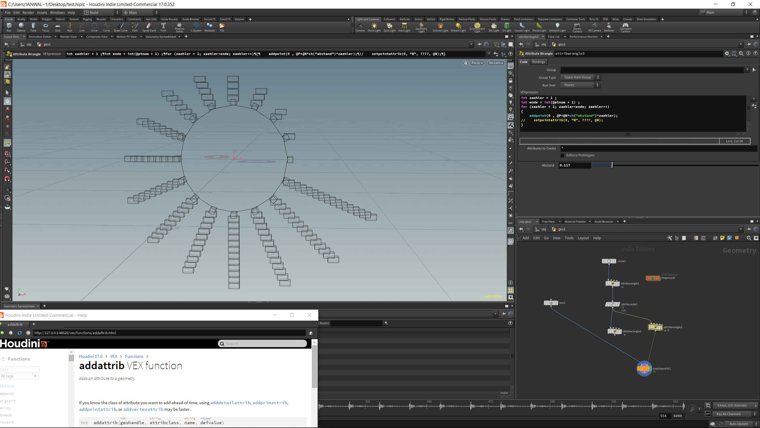

I guess I am missing something obvious, but I am new to Houdini and didn´t find a working solution so far.
I have a circle, added normal and up attributes with help of an attribute wrangle. When using Copy to points, the duplicated geometry is aligned properly.
Instead of just duplicating one object per point, I wanted to duplicate several per point, number according to a certain attribute (in the example I just used @ptnum).
To do so I used an attribute wrangle with a for loop, @ptnum defining the number of iterations:
int zaehler = 1 ;
int ende = int(@ptnum + 1) ;
for (zaehler = 1; zaehler<ende; zaehler++)
    addpoint(0 , @P+@N*ch("abstand")*zaehler);
//    setpointattrib(0, “N”, ????, @N);
And this basically works, just with one problem - the geometry is not aligned properly (apart from the geometry that is copied to the first “original” points of the circle).
I did not find a way to set the orientation - basically the new point(s) just would have to take the same orientation as the according point of the circle already has.
Thanks in advance!

Problem is that you create new points in the wrangle, but you don't set any N for them. So by default they will get a N = (0,0,0).
That's why only the first ring of instances has correct orientation.
If you want to set an attribute after you just created a point in a wrangle you have to reference that new point. So better if you assign a variable to it.
int newpoint = addpoint(0, position)
setpointattrib(0, “N”, newpoint, @N);
then you set the upvector for all the points, which houdini reads as default with @up;
add a new wrangle with following line:
@up = set(0,0,1);
Edited by Andr - Nov. 6, 2018 15:30:55

What I did not fully understand was the part, that addpoint not only creates a new point, but also returns the “index” of this point.
So with that in mind I was finally able to remove the question marks from my setpointattrib line.
And comparing that to your answers shows, that this solution seems to be legit.
