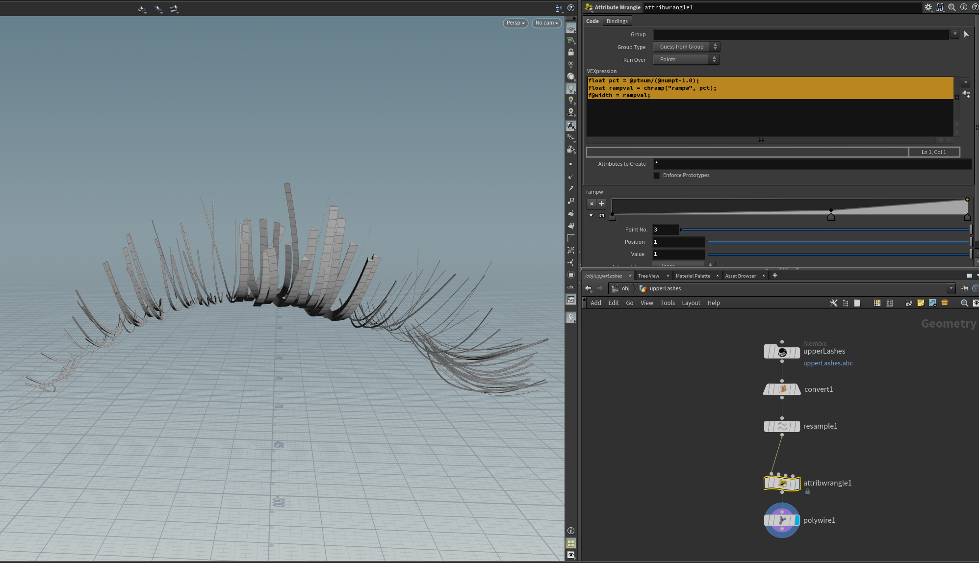

The most promising appeared to be creating an attribwrangle node above the polywire.
Here is pictured:
However, it isn't working as expected… I think my point numbering would have to be on a per-hair basis for it to work? I am not too sure. I am wondering if it would work, if I separated each curve and somehow renumbered them to be the same (eg, each had 0-20 points), however I couldn't work that out. Heres what my numbering is like currently:

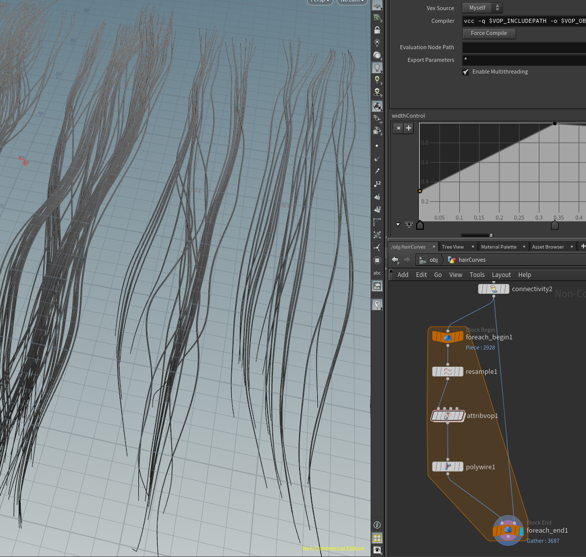

My co-worker helped me figure it out this morning using this method, posting incase it helps anyone else.

Here's your file with the method I was describing too.
hairCurvesExtrusion_mk.hipnc (7.0 MB)
Awesome! Thank you for that, have learnt a lot!
