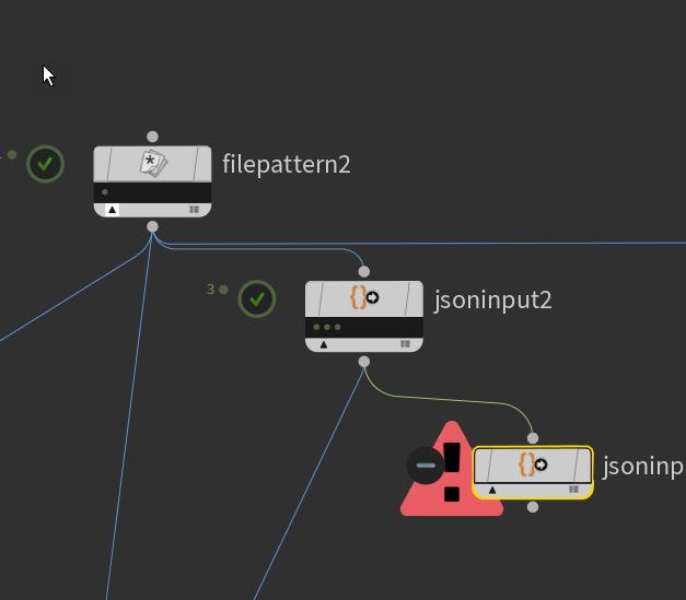

I have two json inputs chained below a FilePattern TOP. the reason i'm doing this is so that i have a work item per root
item in the json so i can use @pdg_index and access a transform per object.

For nested queries, I am using the Attribute Copy node, putting the JSON input on the right input, and my work items on the left, and checking the Copy Result Data flag. That generates all correct inputs for the Json Input node. I also copy top level @pdg_index attributes into new attributes, like @testobject_index if I used the sample file above. Though, it appears like the Json Input node ignores custom attributes. Maybe it is special somehow in that only the json file itself can be passed to it, and nothing else?

It looks like its just not working as intended. Using the attribute copy was progress. I now have no problem getting a WorkItem per testobject. but its dumping the same transform values into each Workitem. with this method im getting 19.9, -8.9, 367.9for each WorkItem. the JsonInput parameters
testobjects/`@count`/transform/0
look to process/iterate correctly. but the result values do not reflect that.
Edited by NDkg - March 22, 2019 12:22:59

Hi, I was able to reproduce your TOP graph and test it out using the JSON file you supplied. It looks like there was a bug in the evaluation of the multiparameter fields which is why they were calling the same values in each work item. This is now fixed in the next daily build!
I've also updated the Array Retrieve “Query” field to evaluate with respect to the upstream work item. This makes it consistent with how Generic Generator's “Item Count” field works (which also evaluates with respect to the upstream work item). These parms are an exception to the rule – they must be evaluated before any work items are created (because these parms actually dictate how many work items will be created), so the next logical behaviour for them would be to evaluate with respect to the parent work item. All other work items evaluate with respect to the created work items on the current node.
With that being said, I'd like to make nested querying more easy. The planned solution would be to add a wildcard operator to the query language. This would reduce your graph to two nodes: a file pattern node to import the JSON file, and a single Json Input node that uses the Array Retrieve operation with these parameters:
Query: testobjects/*/transform
Field: *
Attribute Name: transform
Would this help make your use cases easier?
