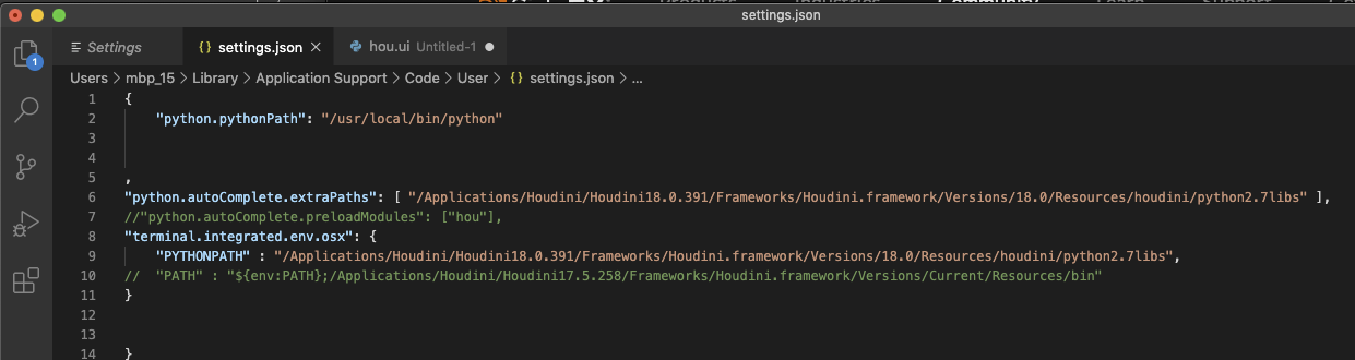

This is what I have done.
Settings (no error messages):
    "python.pythonPath": "/usr/local/bin/python"
"python.autoComplete.extraPaths": [ "/Applications/Houdini/Houdini18.0.391/Frameworks/Houdini.framework/Versions/18.0/Resources/houdini/python2.7libs" ],
//"python.autoComplete.preloadModules": ["hou"],
"terminal.integrated.env.osx": {
    "PYTHONPATH" : "/Applications/Houdini/Houdini18.0.391/Frameworks/Houdini.framework/Versions/18.0/Resources/houdini/python2.7libs",
//  "PATH" : "${env:PATH};/Applications/Houdini/Houdini17.5.258/Frameworks/Houdini.framework/Versions/Current/Resources/bin"
And I put that code in the place where the “The workspace settings file is located under the .vscode folder in your root folder”, as the vs doc said.
I am a total beginner in this so I might miss something very obvious.
Thanks again,
Edited by OdFotan - March 23, 2020 18:06:03

Hi
I actually meant “.vscode/settings.json” as workspace settings. You don't have to touch argv
So for you that should work:
    "python.pythonPath": "/usr/local/bin/python",
    "python.jediEnabled": true,
        "PYTHONPATH":
