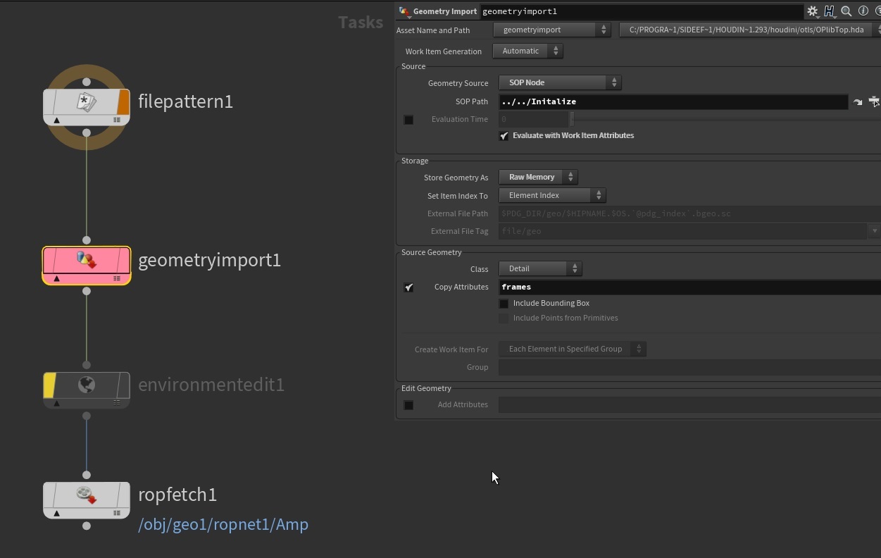

First time using PDG here. I've been fumbling around trying to get this to work, but with time pressures being what they are I'd really appreciate any insight.
See attached image in which I'm using a filepattern to get files from disk, those are then read in the python ‘Initalize’ SOP, in which a detail attribute is set to the number of animation frames. I somehow need to get those number of frames back to PDG so that it can set the FEND environment variable or a PDG attribute that I can use inside my ROP network.

Your Geometry Import set up looks correct. Can you try moving your TOP network outside of the SOP network, e.g. putting your TOP Network into /obj instead of /obj/geo1? When used within a SOP network, the TOP net actually becomes part of the SOP cook so it could be that there's a bug with the geometry import + exporting attributes in that case.

That seems to help. I don't get a freeze any more.
When I import attributes from the geometry import TOP, can I just refer to them via the @attribute syntax in the ROP Fetch? (and the MDD Point Cache Driver I have in my ropnet?)
I can't seem to get the MDD Point Cache Driver's to pick up the correct frame range (I assume this is the problem, as it's erroring out currently, but only after significant writing).

Yep, you should be able to refer to the attributes in expressions on the ROP Fetch. In your case, you should be able to set the ROP Fetch's start frame to 1 and end frame to @frames. The ROP Fetch will cook the target ROP (your MDD Point Cache) with whatever frame range you specify on the ROP Fetch itself.
