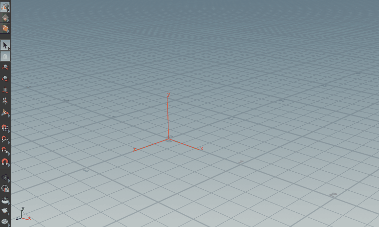

Hello
applied in tablet properties rmb to upper pen's button, but it doesn't work as zooming (doing rotation as grip's tip) in the viewports while holding spacebar and moving
though it works as rmb if just to click (shows VIEW (Space to overlay) menu)
looked in D menu and Preferences can't find something related
with previous Houdini versions worked just fine
have done recently windows reinstallation, but it's the same 10 version
maybe something wrong with wacom drivers and I'd better write to them…
when hand is in the white circle - it's as if rmb associated button for pen in action on gif
thanks for any hints or ideas

out of interest - set too mmb to the lower and rmb to the upper pen buttons -
still the same - zoom doesn't work (doing rotation instead of it)
just have opened Houdini 16.5 everything works as it is with the same pen configuration
have no ideas tbh why it may be so, not sure it's a bug or something, feel more this on my end, but what
even this zooming icon doesn't appear
upper gif 16.5 with pen, lower 18 with pen
Edited by ryuku - Dec. 9, 2019 02:12:47
Houdini 16.5 and Wacom's grip's pen work.gif (7.7 MB)
Houdini 18 and Wacom's grip's pen work.gif (4.0 MB)
