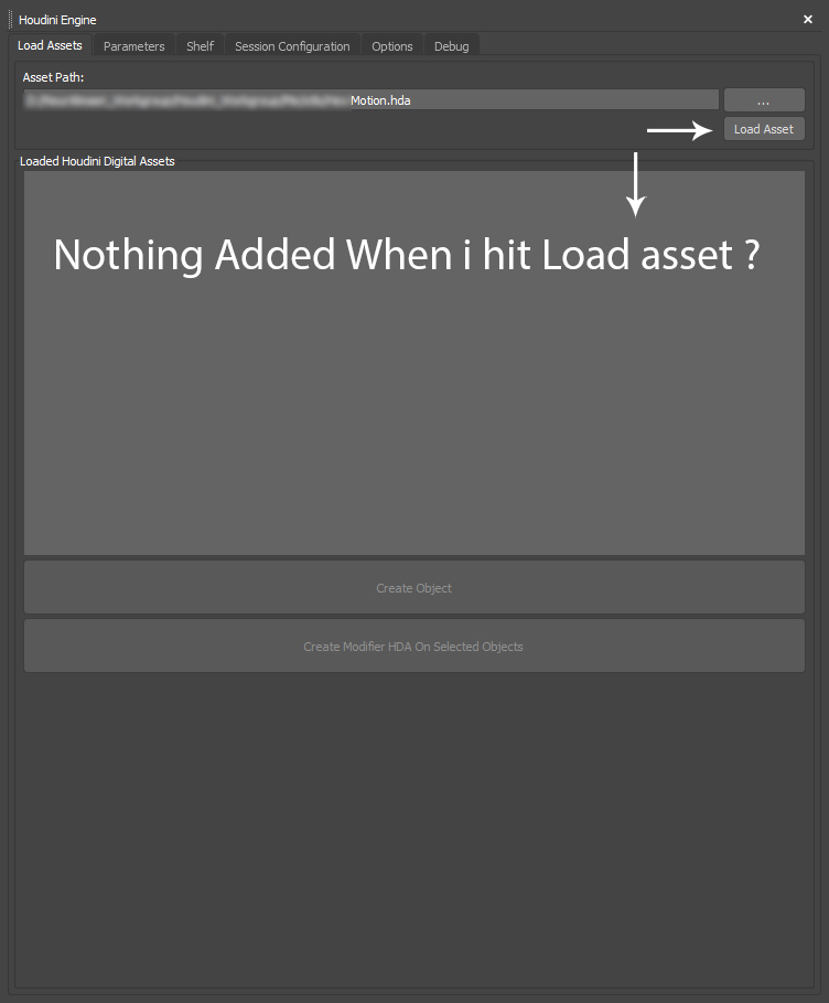

i'm testing houdini engine for max , the plugin is loaded in max , but when i'm choosing any hda and hit load asset , nothing happend , i tried in max 2018 and max 2020 , with houdini 17.5 and 18.287 with the same issue ?

But Create object is grayed out (Disable) ? Because there is no hda loaded in the list, i attached a picture to explaine better
Hda problem.jpg (83.3 KB)

OMG , this is the problem , there is no session , when i press start session , it's working .
