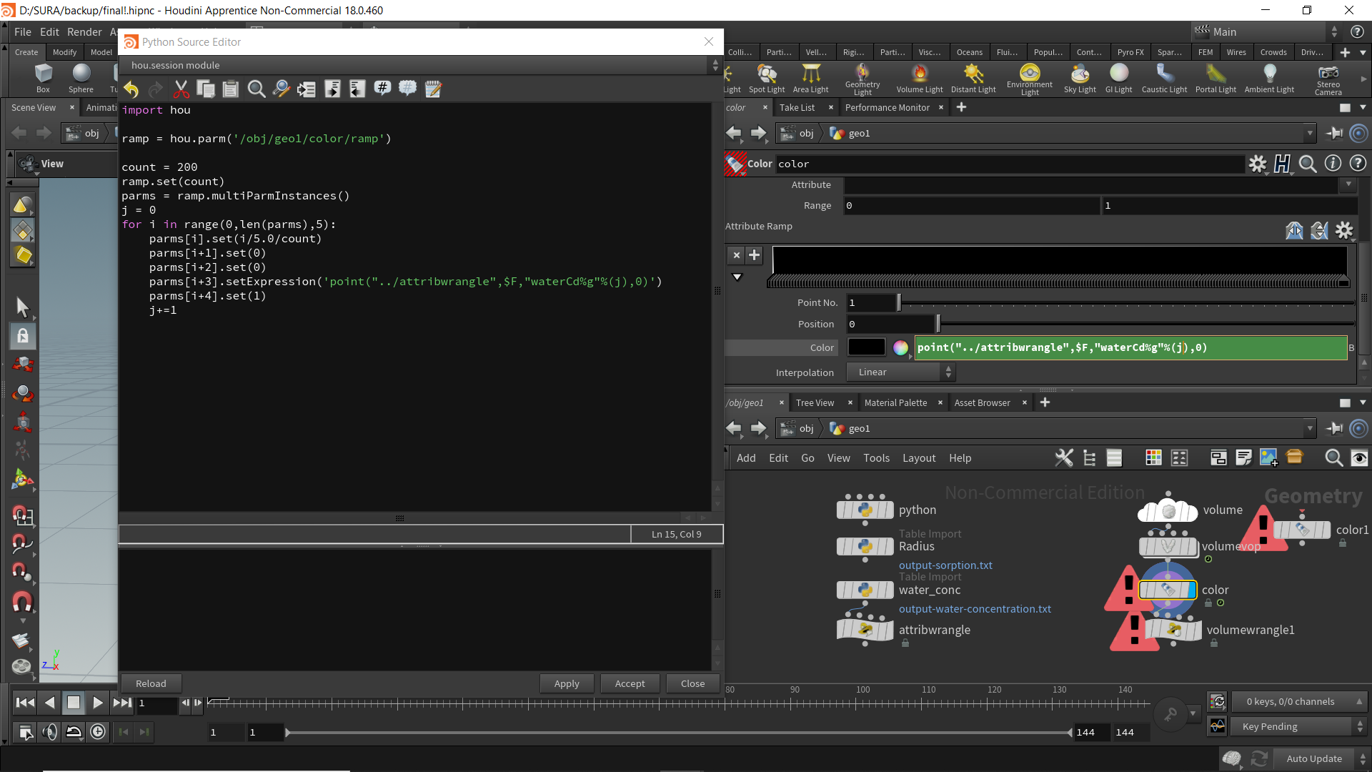

The volume wrangle works well; for color ramp, I modified your coding example, it works for most part, but there is only one problem that I need to give one of the parameter an expression like what I did in screenshot attached. I noticed it did not work like other node's parameter controlled by python. The attribute I need the blue color parameter to read is attribute “waterCd#” with index starts from 0 to 199.
Hope you could teach me the correct syntax~
Many thanks!
