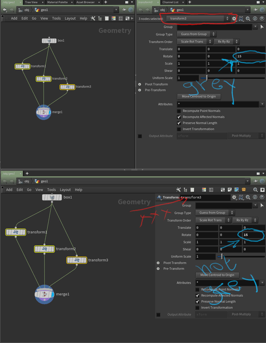

I am trying to change several parameters at once with the selected nodes and it is not changing like before, am I missing something?

The image shows some parameters ui components behaving weirdly on the same houdini 18.5 session.
I just split top bottom and used the “P” to call the parameter ui in the bottom pane.
The top pane is showing a grey value because the 3 parameters have different values the bottom don't.

The bug also happens if the parameter an network panes are ‘linked’ instead of ‘follow current node’.

For linked windows I was able to get it to work by selecting all nodes, then pinning the parameter window temporarily
