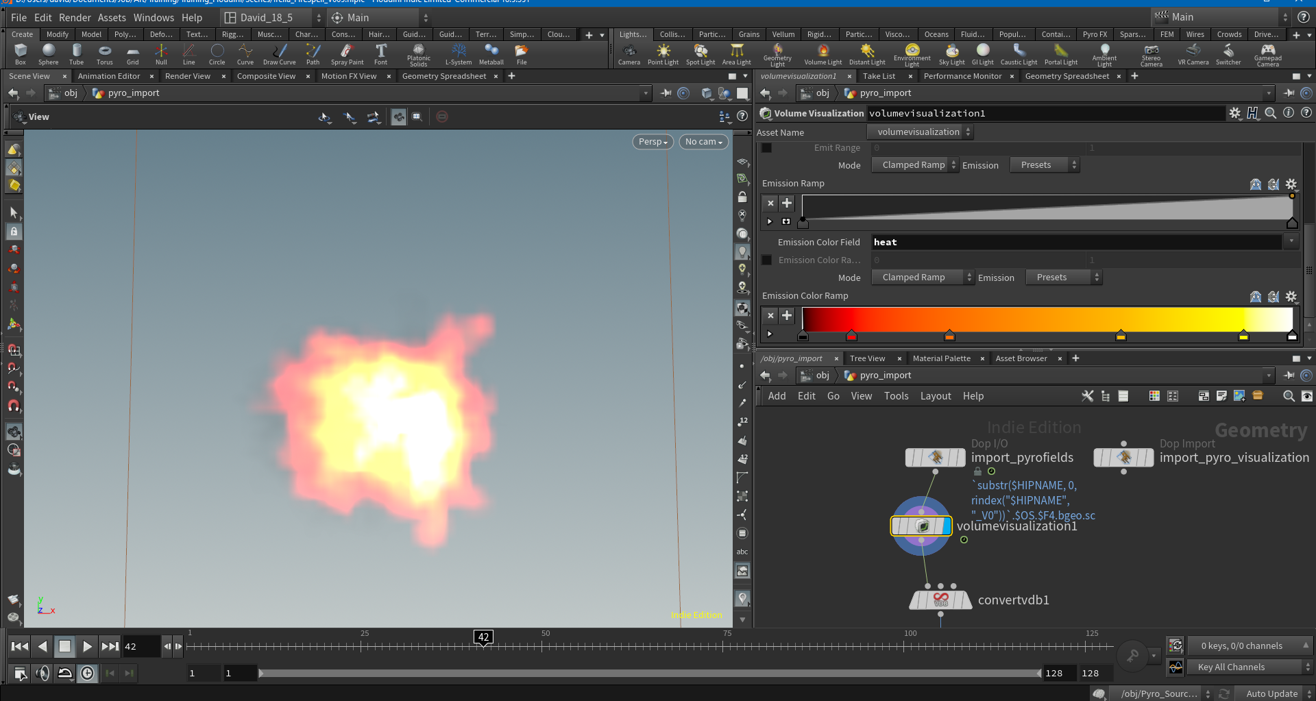

So I did more tests with this scene and I deleted my isoOffset node and replaced it with a "Convert VDB" node.
Check the attached pic : in the "pyro_import" node, I did a file cache from the import_pyrofields and plugged it into a volume visualisation node, in which I have a gradient. Then I plug this in a convert VDB node and in the bottom of my network, I use another filecache node in which I pout the vdb extension.
I understand the volume visualization node is for the viewport only, but is there a way to get these colors exported to the VDB files? And then how can I recover these colors in Maya?
Thanks
Gz
export VDB keep colors.png (496.7 KB)

I reckon you need to remap the same colours in Maya based on "heat" field.
Or remap the heat field the same way in Houdini and export the "Cd" vector field to Maya.
