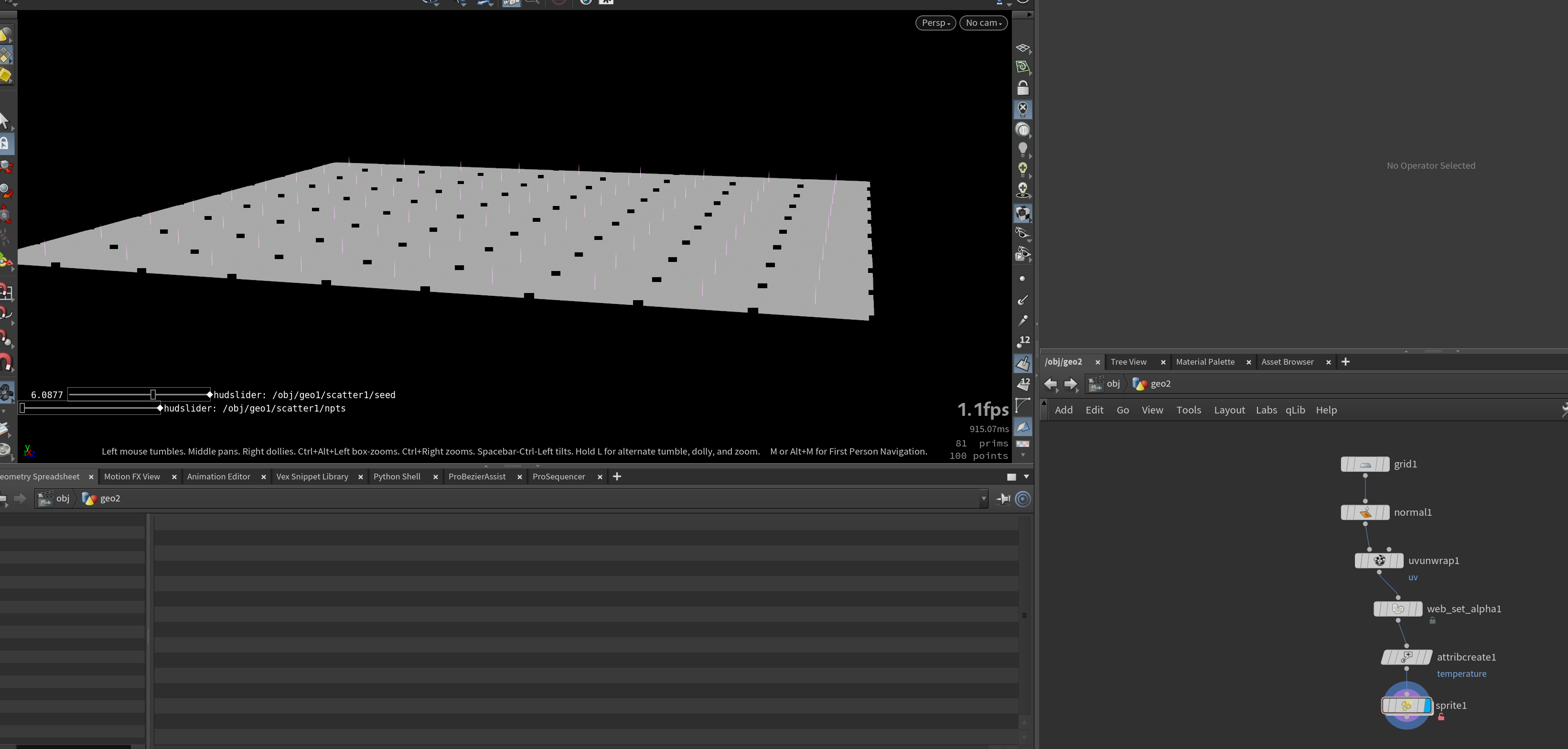

Can't get the sprite node in a POP network to work or the SOP level one either.
Looks like this for me in 19.5:
