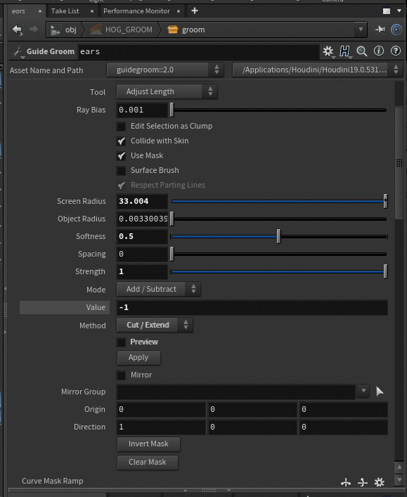

if I correctly recall how it used to work then for me the closest seems Adjust Length with following changes:
- Method: Cut/Extend
- Softness: 0
- Value: 1 (but may depend on scene scale, simply higher value to subtract faster, kept strength at 0.05)
- Softness: 0

Resample utility not working for me either. Re: cut brush, I set the strength to -1 and that seemed to work. Not sure how it compares to the previous behavior though. Edit: meant to say set the "value" to something less than one. Strength is 0+ only.

citizen
tamte's settings for reproducing that mode seem to work
@abvfx but does resample utility even work for you? I get no changes by hitting 'apply' or 'sfiht+R' in viewport. I might be doing it wrong...
Cheers for the confirmation i will try it out once i get on my home system.
Resample does work for me, i selected the selected and then set the point samples and hit apply and it worked. Not sure why it isnt for you or Brian.
