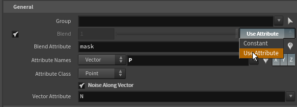

I used to alter the height of the mountain SOP with the height attribute. Since it is deprecated in H19 I use the Attribute Noise Sop. But it is not recognizing the height attribute. What would be the new workflow or attribute name to alter the height.

use the blend attribute.

I was also wondering the same question as OP, could you elaborate on using this?
I can't seem to get this to work with height attribute, can't seem to figure out what I'm missing.

create an attribute float before the noise and it can be anything height, mask, myheight, etc. Then just put the attribute that you create in the blend attribute parameter. That should be it.
