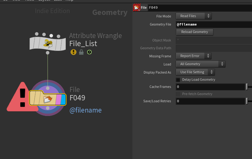

Hi, What's the best way to add variable in File node.
I have files that need to be load depending of the frame. I created wrangle with list of file name. But I don't know how to "send " my names into file node name attribute.
Anyone can help with this? Thx
string fileName[] = {'$HIP/file/F001.obj', '$HIP/file/F025.obj', '$HIP/file/F75.obj'};
s@fileName = fileName[@Frame-1];

Thanks @Enivob, However using $F doesn't really solve my problem as I need to load files with different names.

Another way is to place your wrangle in detail mode and fetch the value of the attribute using a function, instead of a direct reference to the attribute name.
Type this into the Geometry File name: (adjust the path to match the path to your wrangle)
`details("/obj/geo1/File_List/","fileName")`
Notice the backticks. They are required for the function to be evaluated.
Edited by Enivob - Nov. 30, 2021 10:41:54

@Enivob, Thanks! that's what I was looking for, but I didn't know how to properly write the function
