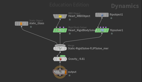

This is the switch system that makes multiple hearts spawn.
Is there anyway I can combine these nodes with my DOP?

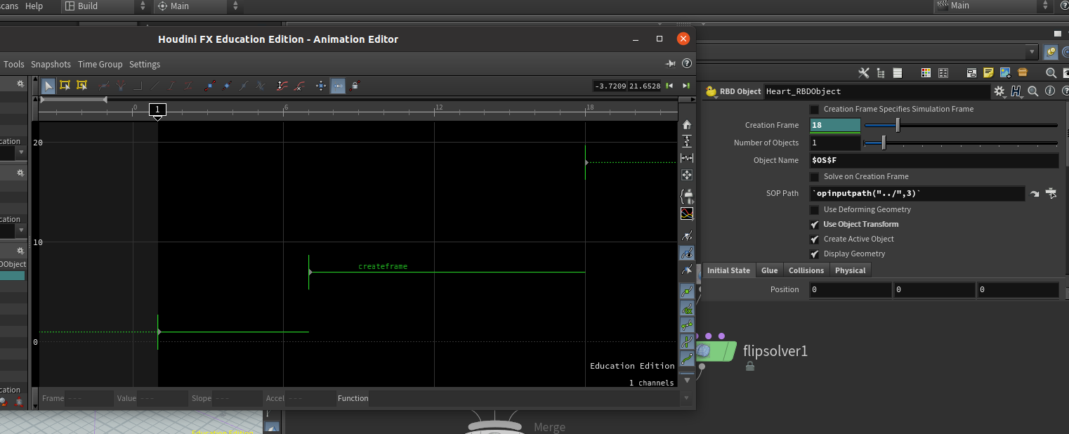

If you keyframe the "Creation Frame" and set object name to $OS$F, it will work.
Note that "creation frame" is a list of frames, it is not on/off. So what I did was add a channel, and set frame 1 to a value of 1, frame 7 to a value of 7, frame 18 to a value of 18, etc. You can then box-select all keyframes and set to "constant" slope.
Edited by mrCatfish - March 22, 2022 13:37:21
Screenshot from 2022-03-22 13-35-38.png (125.3 KB)
