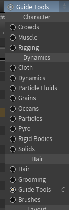

I am using Houdini apprentice, not sure if that is the problem but I have started following some tutorials on grooming here and I am missing the guide brushes menu, which I see in every tutorial. When I try to use the radial menu it says it cannot find the tool.
I can access the brushes when I click on the guidegroom node but It is not all that convenient.
I couldn't find any info on how to get the shelf so I hope someone here can help me out.

You can pick different radial menus and i believe you are looking for this one. When you select this and press c at the viewport, it'll give you the brushes
