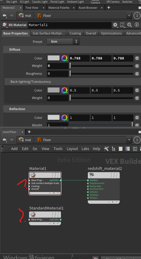

just wanted to know what the difference between the so called material & standard material is?
Kind regards
Martin
Edited by MartinBoue - June 3, 2022 05:34:21
Screenshot 2022-06-03 155657.png (77.0 KB)

The Standard Material is the newer Redshift Material that was introduced in RS Version 3.5.
It has some new options and a simpler SSS workflow.

The Standard material is based on the Autodesk Standard surface material which has the goal to become a standard for various render engines, especially when used with MaterialX.
See https://autodesk.github.io/standard-surface/ [autodesk.github.io]
