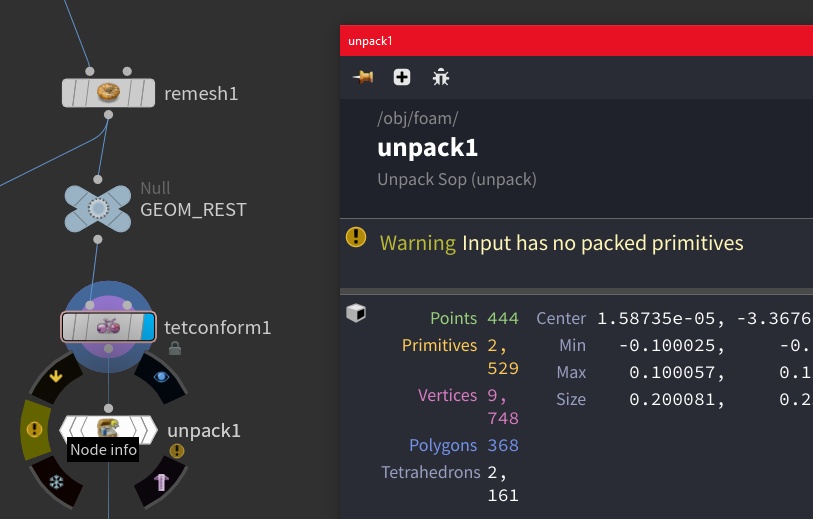

Same "warning" for me on similar vanilla setup (mesh-->remesh-->TetConform into femsolidobject) that I didn't encounter before. Is there a workaround?

Joined: Feb. 2018
Hmm. I'm confused. There are no packed primitives in my case: Box-->Remesh-->TetConform isn't packed.
Oh, it looks like a bug in TetConform: if I enable "Preserve Input Geometry" in TetConform, it complains. If I disable that, then it is fine.
