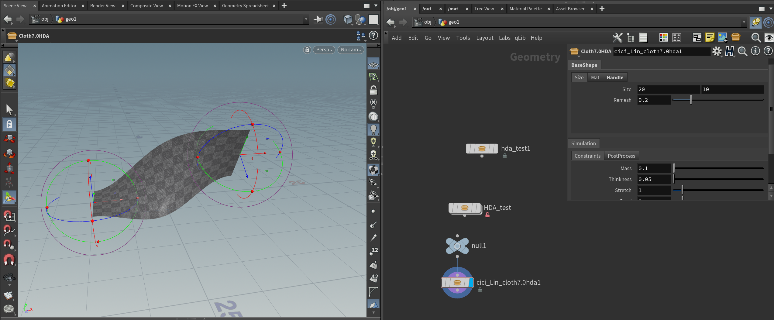

Hi guys!
I really need help.I just made a HDA in houdini about cloth and it works very well. However when I try to bring it to unreal,It just show the logo of Houdini. I don't know what's wrong with it.
2022-08-28 211941.png (1.2 MB)
2022-08-28 212036.png (1.0 MB)
cici_Lin_cloth7_0hda.hda (86.9 KB)
17 posts
Joined: May 2021
Can you check the output log for any error messages?
There might be an issue starting the session or running the hda.
