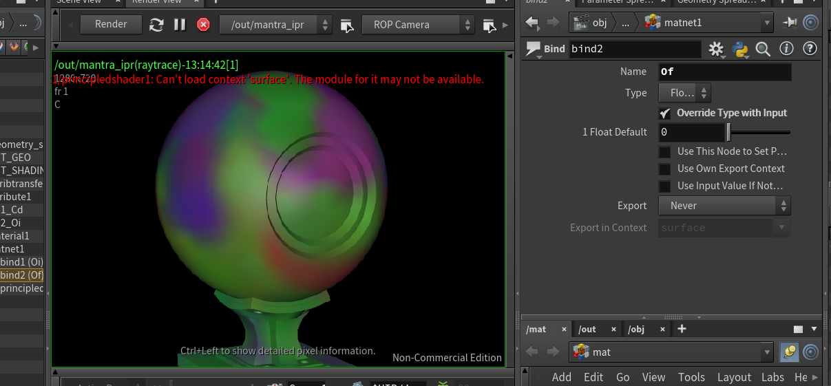

From the screenshot the type should be color not color array.

Thanks guys, (but it does not work, no idea what is missing)
if I do this (rename Oi to Cd) the Cd is read easily from the shader itself. This is what is expected to happen with the Bind node.
My Bind node seems like it is dead.
The other Bind node is the same.
Pulling Transparency manually works immediately.

Thanks animatrix_, Andr and especially ajz3d,
thanks to your advice, and a calm moment of fiddling with numbers, this also works with Mantra and Karma (ajz3d's contribution).
The missing piece of the puzzle was that (Houdini) OpenGL does not support this out of the box, so rendering must be done with Mantra or something equivalent. Also, using OpenGL to interpret the shader is a mistake (I should know this). However ajz3d showed how to do this with Karma as well.
The idea of using attributes (replacing maps) is just one tool in the toolbox when dealing with shading. However, it is one that does not require UV:s or UDIM:s, and for that reason it is important imho. Other methods that do not require UV:s are Houdini groups and (probably) image projections. Maya also has something like "3d" materials (can not remember the proper name) and I'd expect Houdini has something equivalent.
This is a small step for man, but... I'm so relieved! Now on to the next challenge.
