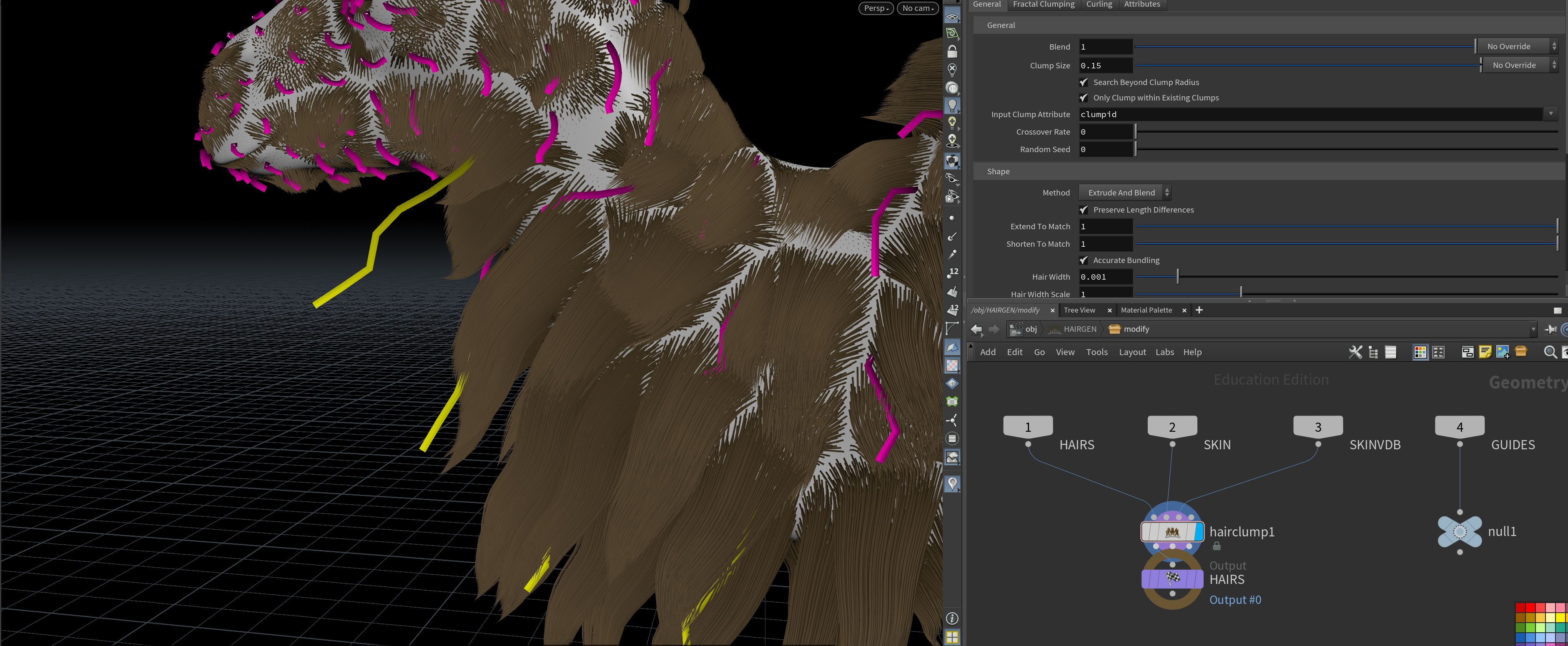

I am using the hairclump node inside my hairgen with Houdini 19.5.569. It appears that they do not correctly follow the direction of my guides, and I am not sure if this is a bug, or working as intended. Is there a way to set the clumping to follow my guides correctly? It looks like the the clumping is being interpolated between the guides, rather than following them directly.
Also, every tutorial I have checked uses the hair null instead of the guide null. Using the guide null results in very odd results on the screen, as if the hairs are all resting on top of the guides.
Attached is an example image.
Thank you.

The 4th input to the hairclump is for clump guides.
Well, there we have it! Thanks very much.
