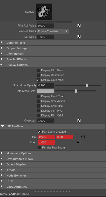

I would like to resolve the questions that arise when integrating 2D PanZoom data between Maya cameras and Houdini cameras.
I understand that in Maya, the 2D Pan Zoom can be achieved by mapping the horizontalPan and verticalPan values to the Screen Window X and Y parameters of the Houdini camera.
However, in Maya, there is only one parameter for Zoom data, whereas in Houdini, the Screen Window Size is divided into separate X and Y parameters.
Is there a standard method for integrating these two systems?
