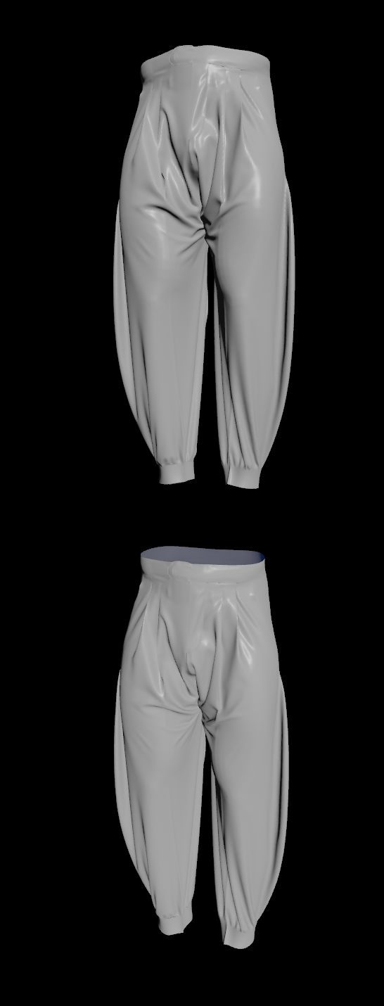

Thanks for the reply. How would i go about checking that? I noticed that when importing into ZBrush the export settings have the XYZ offset sliders not at 0. I also deleted the FBX_scale , rotation and translation attributed but it did not change.
As you can see in the image. The bottom is the houdini geo and the top is the geo imported and exported from Zbrush

Using the rop Geometry in obj. has worked but with the rop fbx i still get that offset.
