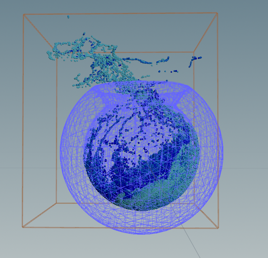

I'm trying to create the water inside a geometry with FLIP Solver SOP.
But, If completely enclosed by collision geometry, the water will be lost.
If some of the collisions have holes in them, I can simulate something close to what I am looking for.
I would prefer to use collision geometry without holes, anyone got an idea on how to do it?Can we do that using the FLIP Solver SOP node?

Usually its enough to load in the collision sdf into the sim and inverse it.
do not know how to do it with flip sop solver though.
Have a look at the hip
TestFlipSOP_fix.hipnc (1.2 MB)

Thank you for the HIP file.
It was very helpful.
It would have been great if I could do it with FLIP Solver SOP, but I would like to make it with DOP for the time being.
