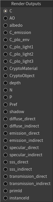

Hi all,
When trying to check AOVs in a karma live-rendering Scene View, it's an exercise of repeatedly clicking the "viewing output" button to access the list of AOVs and select-clicking an AOV to check.
It is slightly better if the render is snapshot in Render Gallery. It's still quite some clicks in the Image Plane drop-down menu in order to check multiple AOVs.
Is there a hotkey or a way to assign hotkey for cycling through, going up/down the AOV list, and back to top (the C output). I believe these hotkeys are available in Katana and Nuke.

Shift + [
and
Shift + ]
is the answer for Mplay, not sure if it works in Render Gallery

Thanks! works in Render Gallery. Think I find them in the Hotkey Manager. Hoping there is a way to go back to beauty (C).

Press 'c' to view C/Beauty.
