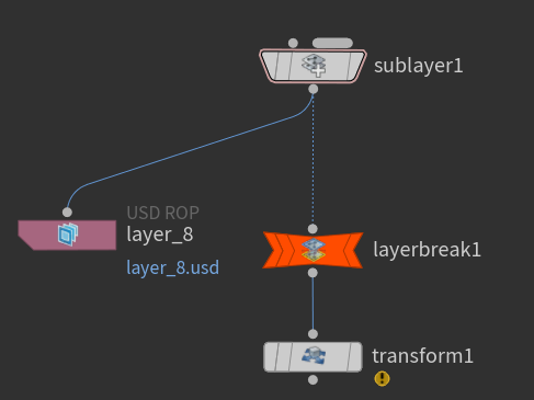

Hi, I have a network in Solaris:
I'm trying to get hold of only a layer with the transform1 on sublayer1 or a stage taken from transform1, without grabbing the whole stage including sublayer1. Layer break node doesn't work unless I connect a USD ROP node and save that transform to drive. I don't want to do that, instead I want to grab a string stage from transform1 node to do other things with it.
I've tried this to get hold of transform1 node's stage while cutting out the sublayer1 (I'm exporting to usda to assess what the layer looks like):
stage = editNode.stage()
layer = stage.GetEditTarget().GetLayer()
layer.Export(exportpath.usda)
But instead of this (in .usda exported through USD ROP):

I get this (with the transform not being inside the 'over "Default Prim"' part:

When I stream the latter transform's usda to Omniverse Kit's viewport, it doesn't do anything. I'm wondering whether it's because it's missing the former's customLayerData or whether it's something else...
I'd appreciate any suggestions
