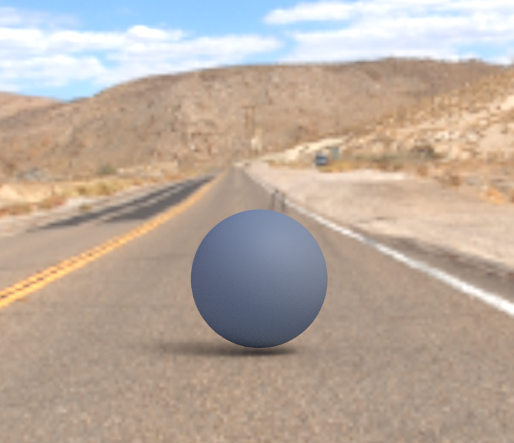

Hi Doudini, your English is good, don't worry
I tried your scene, the shadow is nicely cutout, but the problem will be with the compositioning when using Environment light with image background. I used your scene, slightly modified and I am posting it in next post. And please look at it and test it (use Cam1) and please let me know how to do the result look like on my next picture. All I want is to achieve result as on my render from Maya and RenderMan I did now - see this image:

you have modified the wrong take when you made the changes to the hip file. Should have worked from the Main Take to adjust cam position for example. When making changes to the scene always do it on the main take.
Also I see what you mean with the plane cutting out the environment map, for that you can put: -primary in Render Visibility (Phantom) and this will solve it.
But anyway, I modified the file so the bg is separated in its own pass so there is no need to do this. So you will have 3 render nodes. Rendering the bg, main object and shadow.
Check the IMG context to see the rendered result where the bg, shadow and sphere are combined.
I also added a second plane without the Shadow Matte Shader which enables indirect diffuse. Render Visibility is set to -primary. Without it there was no indirect diffuse since the Shadow Matte shader.
let me know if it helps

I have modified the “Main” because I just wanted to prepare the base scene for you, so you can do miracles
Yes yes yes, thank you very much! Now it looks it is doing what I want. But why is it so complicated?
I made a short composition of your renders in Nuke because Nuke I understand better than comp in Houdini. Your solution is clean, I like it.
I am now diging through your scene to understand all you did so I can replicate it in the future. One small question, where did you get or how exactly did you created your “v_shadowmatte1” material?
Can I ask your for text detail of all steps what to do exactly? I saw a lot of posts over other forums as well asking for the same thing. You can make it as a base step by step tutorial for all others. I know it take some time to do it, bu tit can help a lot of people.

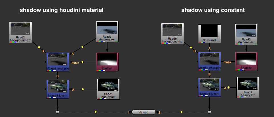

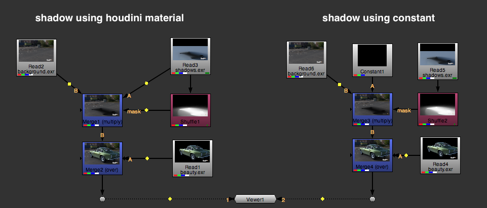

So finally I've figured that all out. It is in fact simple. Just using 2 takes, one for separating the shadows under the car, second for the beaty pass of my car. One ROP network, inside 3 render nodes - first for shadow pass (with extra pass direct_shadow), second for the beauty pass of the car and third just an environment background. There is no need to use shadow_matte material. For my floor plane alias shadows catcher I used a built-in Material Builder, tweaked the shader little bit to be close to the env asphalt. Rendered and then comp in Nuke. In Nuke I have two ways how to comp it, (1) first using the shadow material defined in Houdini and (2) second using constant or anything you want. In Nuke you have free hands.
Yes, it would be nice to have a possibility to see the result of shadows in preview render immediately without need to comping it, like for example RenderMan, V-Ray etc. offers.
If you wanna test it yourself, I attached the whole scene, images, renders and Nuke comp file into one zip in the next post.
Only one problem I still didn't solved - in my beauty pass of the car alone without the floor plane and environment, the environment is still visible in the windows and it should not be there.
