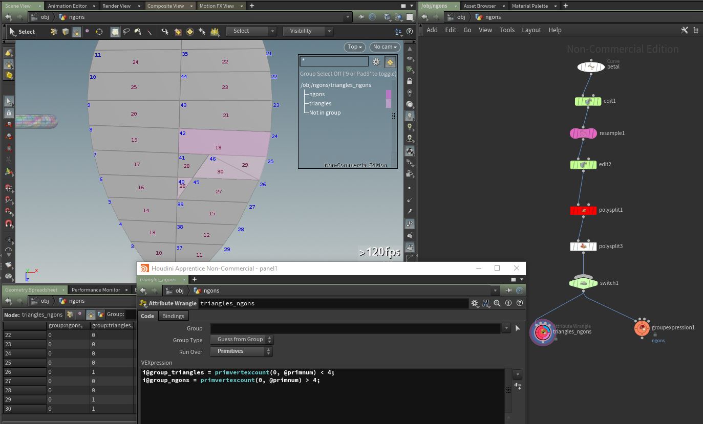

171 posts
Joined: 10月 2016
i thought it should be written in probably Wrangle, but i don't know where to look for the counted result and how to highlight or color them in the viewport and if there should be smth else except these strokes?
in groupexpression seems it works, but how to type another variation > 4 ? to create two groupexpressions - one for < 4 and one for >4 ?
Edited by ryuku - 2019年12月22日 13:09:41
171 posts
Joined: 10月 2016
will think that doing so i'm doing it right
