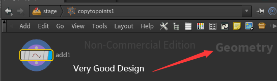

A node such as Instancer Lop has a dedicated inner sop context. It keeps the path of the inner node short and has clean logic. I think it is a very good design.
On the contrary, the Sop Create lop, the most important node is only a hda.
Why not give it a dedicated sop context like Geo Object node for performance and logic?
And the sop import and sop create node can be merged into one node like Instancer if we have a dedicated sop context.
