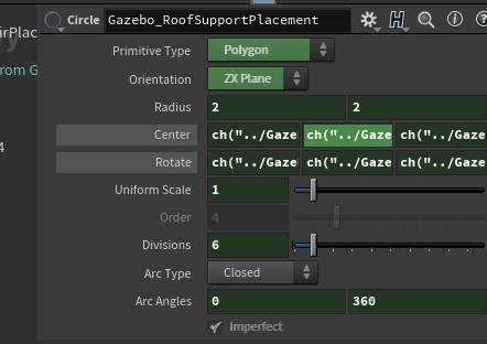

Hey, I am not yet experienced with coding in Houdini @animatrix,
I've tried your code and all the extra points are stacked on each other.
@CYTE
I've tried a few solutions but all of them give me the same result where nothing changes.
Maybe it has something to do that the shape is linked with different attributes. I am practicing procedural modeling.

It would help to see your geometry because there are a lot of nuanced differences between polygonal curves in Houdini.
