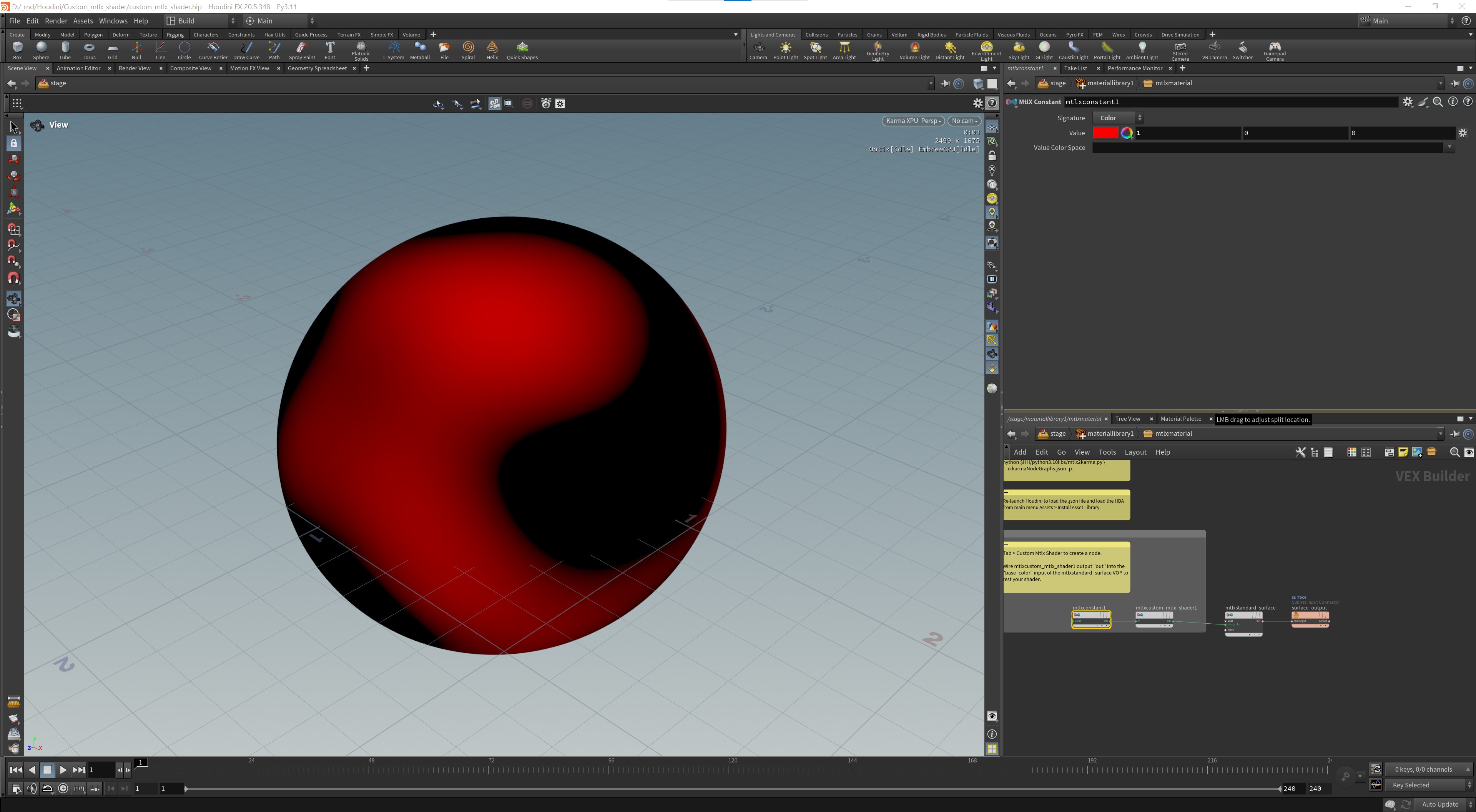

Actually HoudiniGL seems to recognize the karmaNodeGraphs.json file, so it renders the new custom shader as long as it's implemented entirely with standard MaterialX nodes.
The rough steps are:
1) Build a subnet VOP containing the implementation of your custom shader. There are some annoyances with defining subnet inputs and naming them. Pretty much the input name is imposed by the Subnet VOP, and will need to be hand-edited in step 3.
2) RMB > Save > MaterialX... to a foo.mtlx file
3) Hand edit the foo.mtlx file to add the nodedef element for you shader. Also delete the shader nodes that are outside of the nodegraph but were saved nonetheless in step 1. Remember to remove references to them from the nodegraph's inputs and outputs.
4) run the `mtlx2hda.py` and the `mtlx2karma.py` scripts on the command line to create an .hda file for Houdini (to crate new VOP nodes) and .json for Karma to render them.
5) test out by restarting Houdini, loading .hda and creating a new node.
Here is an example .hip file with steps described in the sticky notes. This file works in my setup. The .hda and .json files should be put in Houdini search path, but they also work if you just start Houdini from the command line in the foo subdir.

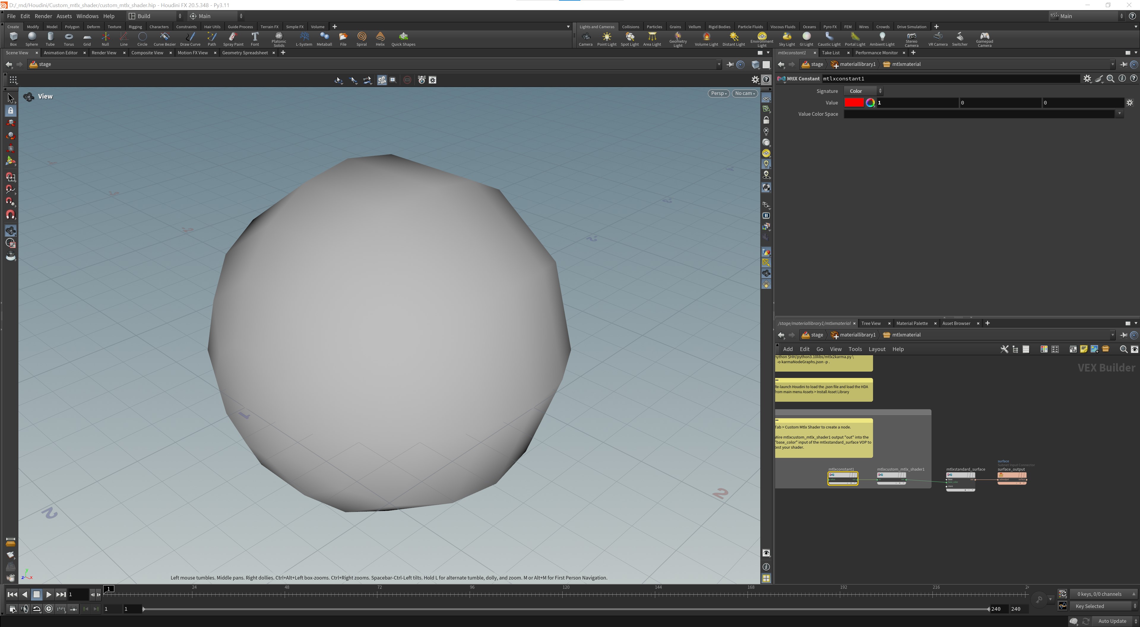

I couldn't manage to make it work in GL, even though the original hda works fine. Hopefully this is my fault. Loosing GL and also loosing the flexibility from an HDA makes me think the speed gain alone isn't worth the hassle.
