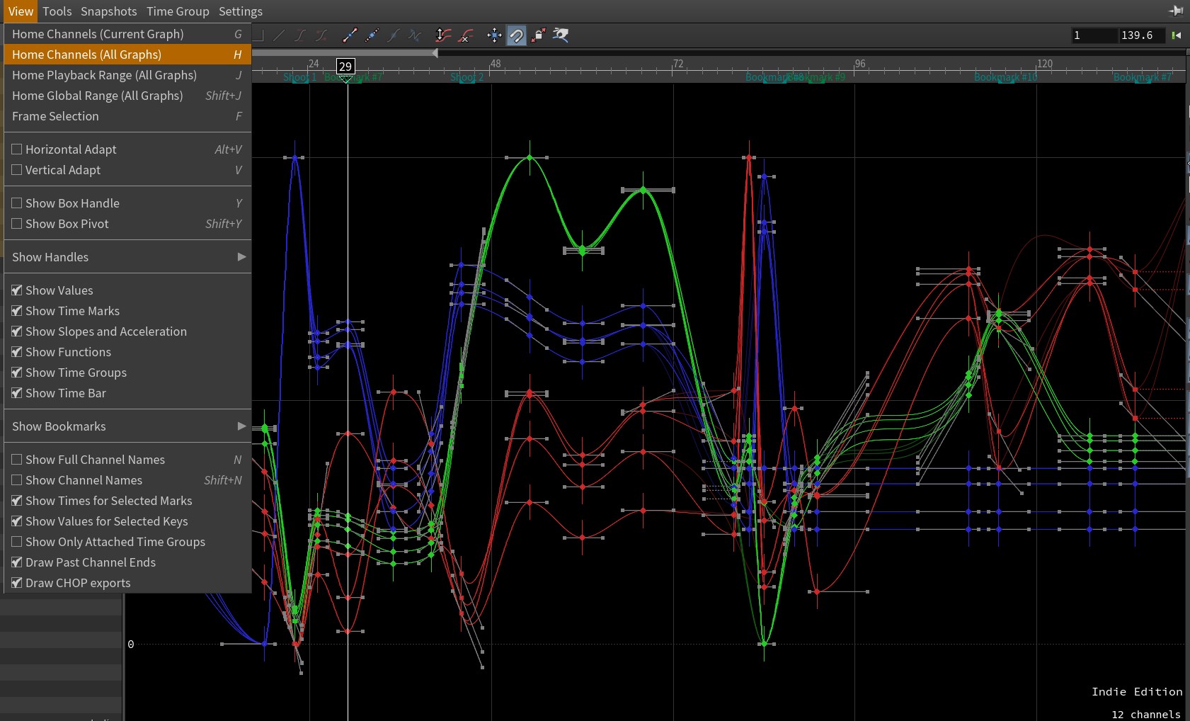

I can't figure out how to do the most basic thing in Animation Editor: jump to the current frame.
It has many commands to "Home" to different sections. But none of these jumps to the current frame. By current frame I mean the frame shows on the playbar:
Not currently selected keyframes.

I'm not sure I understand: what does it mean to jump to current frame, what do you expect to happen? Also, I'm not sure why the current frame in your anim editor is different to the one on the timeline, unless the screenshots are taken at different times.
edit: ok, I've missed an important detail you mentioned, so I guess I'll reframe: how did you come up with different times on playbar vs anim editor? They move in sync for me.

I noticed in the changelog that from h20.5.301 daily builds there is now shift+f to scroll the view to the current frame.
