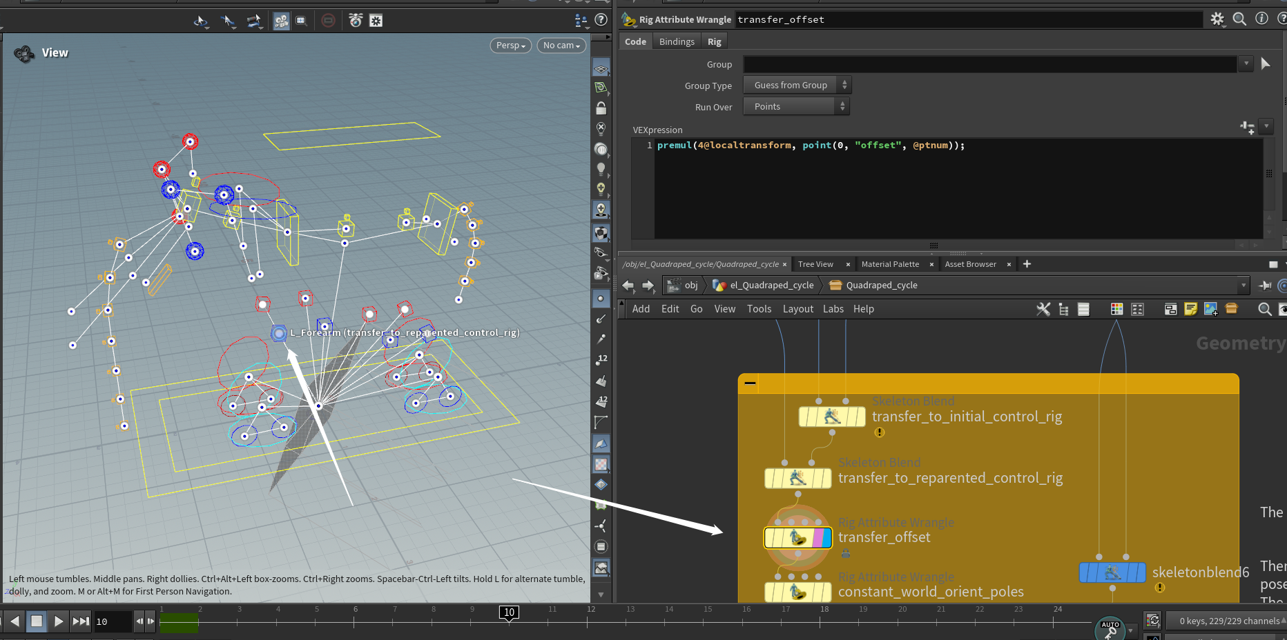

From what I learned this part adds the control shape, and construct an inverse foot skeleton (for reasons I don't know). And I don't understand why the forearm and calf node has been offset. Is it been moved to mark the pole location?
2.Next is this part
I can understand that it blends input animation into the control skeleton ( the skeleton with control geometry). But the joint appears in apparent pole vector location is called L_forearm, and the joint in apparent real forearm location is called L_forearm(transfered to reparent control rig)
I test the upstream nodes and found that the foremarm and the calf node got "duplicated" in this Rig Attribute Wrangle node.
It seems that this wrangle only sets the affected point's transform matrix to world orientation but the viewport shows two joints for each of them. How did the duplicate happens? And if we use a skeleton node to check it we can find that the actual skeleton does not recognize the *_forearm_reconstructed_hireachy joint. What does this mean?

Hi, Is there a specific reason you would want to build the rig in kinefx?
Apex is much better suited for building rigs for animation.
